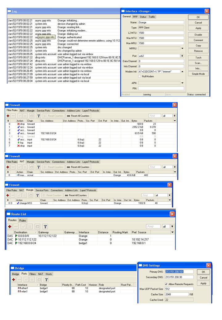

The picture does not show the entire firewall rules. What is that first “chain=forward action=drop” rule? With the firewall filter, order is important.
Do you have a good default route to the internet set in “/ip route”? I can see the route but not the “reachable” part.
Do you have you localnet masqueraded or src-natted correctly in “/ip firewall nat”? I can see part of the src-nat, but not all.
EDIT: How is the bridge “bridge1” set up? How do you have your ip addresses set? Which interface connects to the internet?

The NAT and DNS seems to work fine when using my FTP client for downloads. It seems only browsing the internet that does not work. The browser, firefox or explorer, all repsonding the same way. The browser finds the website in the URL and is them "waiting for www.....
The details are:
Interfaces:
Flags: D - dynamic, X - disabled, R - running, S - slave
NAME TYPE MTU L2MTU
0 R ether1 ether 1500 1526
1 R wlan1 wlan 1500 2304
2 R bridge1 bridge 1500 1526
3 R Orange ppp-out 1440
ppp-client:
0 R name="Orange" max-mtu=1500 max-mru=1500 mrru=disabled port=usb2 data-channel=0 info-channel=0
pin="" user="" password="" profile=default phone="*99#" dial-command="ATDT"
modem-init="AT+CGDCONT=1,"IP","internet"" null-modem=no dial-on-demand=no
add-default-route=yes use-peer-dns=yes allow=pap,chap,mschap1,mschap2
Firewall:
0 chain=forward action=drop connection-state=invalid
1 chain=forward action=accept connection-state=established
2 chain=forward action=accept connection-state=related
3 chain=forward action=accept connection-state=new src-address=192.168.0.0/24
4 chain=forward action=log src-address-list=!192.168.0.0/24 dst-address-list=192.168.0.0/24
log-prefix="unwanted"
5 chain=forward action=drop src-address-list=!192.168.0.0/24 dst-address-list=192.168.0.0/24
6 chain=input action=accept protocol=tcp src-address=192.168.0.0/24 dst-port=22
7 chain=input action=log protocol=tcp dst-port=22 log-prefix=""
8 chain=input action=drop protocol=tcp dst-port=22
Nat:
0 chain=srcnat action=masquerade out-interface=Orange
route:
DST-ADDRESS PREF-SRC GATEWAY-STATE GATEWAY DISTANCE INTERFACE
0 ADS 0.0.0.0/0 reachable 10.112.112.121 1 Orange
1 ADC 10.112.112.121/32 10.192.55.191 0 Orange
2 ADC 192.168.0.0/24 192.168.0.1 0 bridge1
Bridge:
0 R name="bridge1" mtu=1500 l2mtu=1526 arp=enabled mac-address=00:0C:42:4D:40:22 protocol-mode=none
priority=0x8000 auto-mac=yes admin-mac=00:00:00:00:00:00 max-message-age=20s forward-delay=15s
transmit-hold-count=6 ageing-time=5m
Bridge ports:
INTERFACE BRIDGE PRIORITY PATH-COST HORIZON
0 ether1 bridge1 0x80 10 none
1 wlan1 bridge1 0x80 10 none
the formatting didn’t come out well. Details are easier to read in the enclosed txt

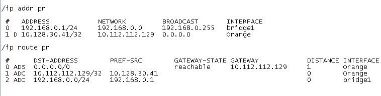

Look at entry 1. That pref-src is not in the range of the localnet (/32). Are you certain that assignment is correct? Check you “/ip address” and see if that IP is assigned the correct netmask. Unless it is dhcp from your provider, of course. Then that could be the challenge.
Thanks,
I have another mikrotik connected to a wired PPPoE connection with simlar settings for the PPP and the routing looks similar.
/ip addr pr
ADDRESS NETWORK BROADCAST INTERFACE
0 192.168.0.1/24 192.168.0.0 192.168.0.255 bridge1
1 D 10.128.30.41/32 10.112.112.129 0.0.0.0 Orange
/ip route pr
0 ADS 0.0.0.0/0 reachable 10.112.112.129 1 Orange
1 ADC 10.112.112.129/32 10.128.30.41 0 Orange
And this is how is looks on the other router with the PPPoE connection

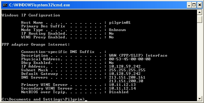

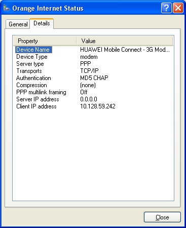

Connecting using the USB port in the PC the connection is good and is using the following IP’s

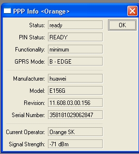

Using the USB port in RB411U I get the following connection with the default profile. FTP download and skype is working, but no internet browser works. DNS is working and I get positive respponse on pings to domain names.
Does this indicate that I need to specify an IP in the profile? I simply have no clue where the problem is.
rgs Pilgrim

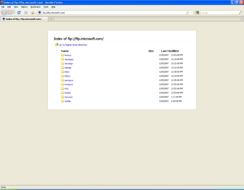

Just to be clear…can you go to a FTP site with your browser? Or are you using FTP software?
I was using filezilla. I didn’t try using the browser. I will make a test.
rgs Pilgrim
Since it works with Filezilla, then if it does not work with your browser, I would suspect a browser configuration challenge. Firefox is “edit/preferences/advanced/network”. IE is in “Tools”.
FTP worked without any problems using the browser. It really seems only tp be the HTTP traffic. Please don’t give up on me. I really have no idea any longer where this problem is rooted.
rgs Pilgrim
