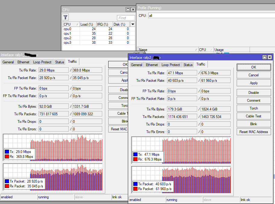

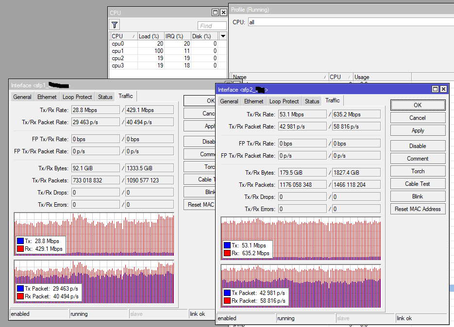

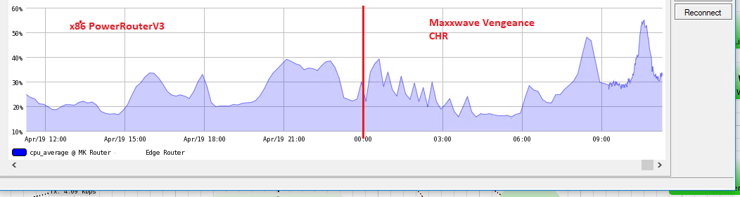

Attached is my CPU usage prior and post Vengeance install. I am hitting periods of extended 50+% usage during non peak hours where I usually would only hit 40-50% usage during peak hours.
Also attached is the traffic usage both before and after the swap. I have two BGP peers getting full tables.

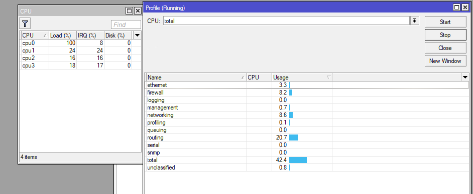

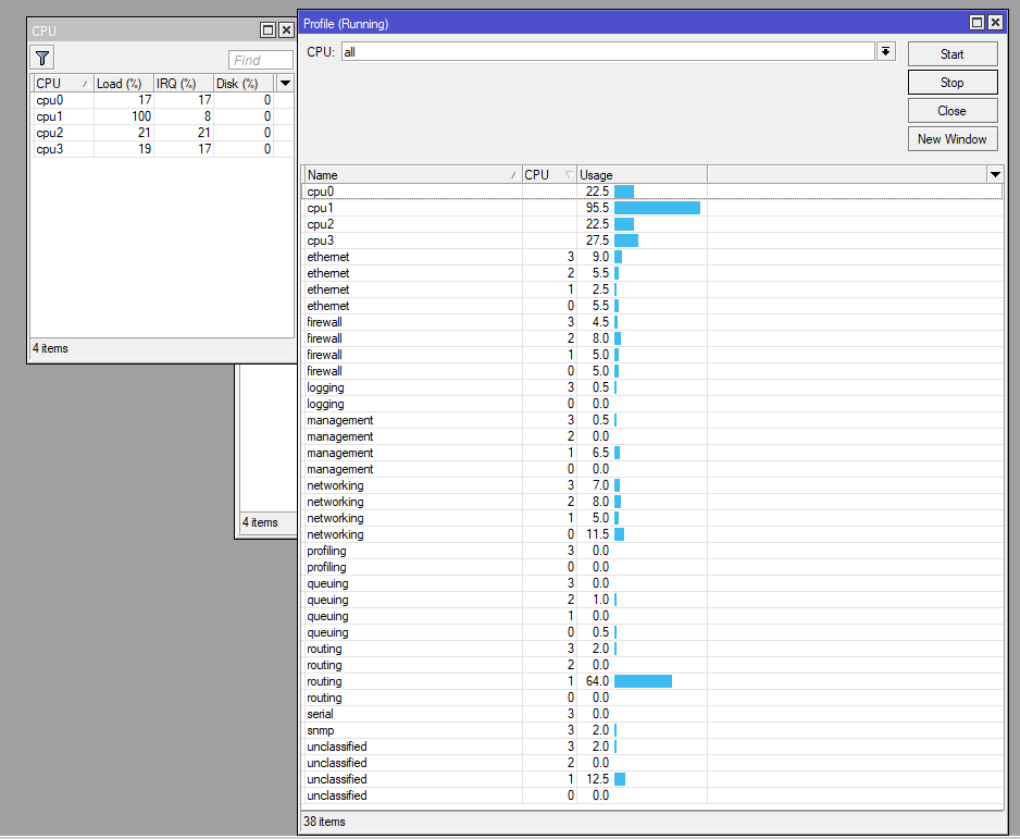

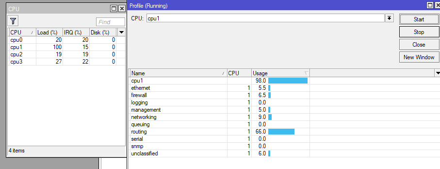

Looking at the CPU profile in Winbox it seems the every few minutes one of the 4 core goes from 20-30% usage to 100% usage. This corresponds with a sudden increase in the routing process. Not sure the cause as there was no sudden spike in traffic.
So it looks like most of the time 3 out of the 4 cores show little usage on the Routing process. Is the routing process multi-threaded? What could cause one core to be randomly taking on almost all of the routing duty?
Routing process
Routing process just a few seconds later with no major jump in passed bandwidth.

The periodic 100% on one core load is caused by the BGP table scan which is run in set intervals and is normal behaviour if you have one or more full bgp tables on the router. This is less impactful on Hyper-V than on VMware if i remember the presentation about CHR hypervisors correctly.
