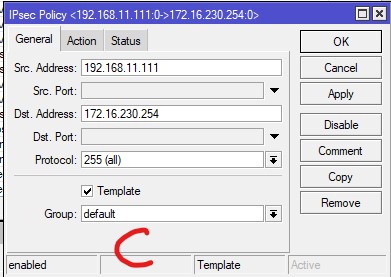

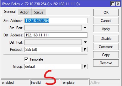

You have combined multiple configuration methods that don’t play well with each other. Namely:
- at the initiator (“client”) side, you use mode-config and generate-policy different from no on the /ip ipsec identity row but at the same time you have a static policy linked to the peer, and there is no policy template in the group “My group” to which the identity refers.
- at the responder (“server”) side, the situation is the same, except that there, the static policy referring to a responder peer should be marked as invalid because no particular address is configured for the peer it is linked to so the policy has to be generated in order to inherit the sa-dst-address from the actual address of the remote peer.
So I’d say set template=yes for the policy at both devices (which will make the peer and tunnel properties irrelevant) and you should be good - both peers will generate the policy from this template.
The group value default is wrong at both, unless you’ve changed also the policy template group on the identity row to default. According to the configurations you’ve posted, it should be My group.
In fact, the group parameter is useless for a non-template policy, so as you’ve converted a static policy into a template, Winbox may have ignored the value set previously and assigned the default to the drop-down.

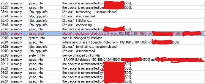

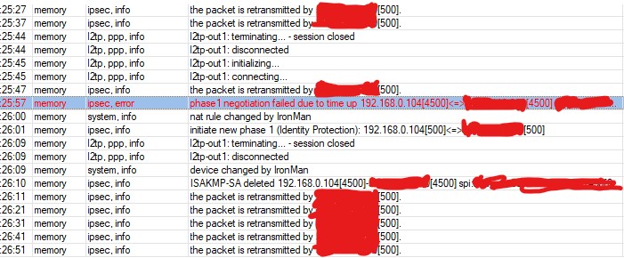

I tried to connect with client to server again with L2TP but got these logs:
on client:
on server:

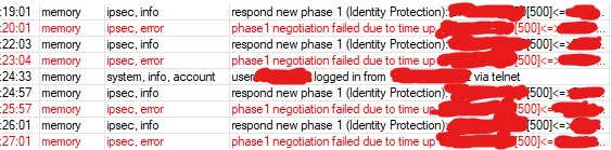

Well I don’t know and the guy setup the client (home) and the server (he is the owner(I got the server for 1 month to see if it’s any good for sha512 IPsec IKEV2 (he supposed to setup that but since I didn’t had the static IP on the client side he refused and said find a way and do it yourself. so here I am
))) and another router in other place, so if there is anything wrong with the firewall and the settings and configurations or there are leaks to fix I would highly appreciate it if you tell me how to fix them.
About the server side I don’t know about the client (home) there is just a TD LTE modem with default settings from ISP (the modem is locked) about my another router which is connected to a ADSL modem (bridge) also with default settings on the modem.
OK, the title says IKEv2 but we’ve silently moved to L2TP. Never mind, just run /tool sniffer quick port=500 on the server, and try connecting from the client. If it shows nothing, the problem is not in the server-side Mikrotik but most likely on the router(s?) standing between that Mikrotik and the internet, where the port forwarding is not configured at all or is configured incorrectly. Another possibility is that you’re connecting to a wrong address.
Since the client side is LTE, chances are close to zero you could use pinhole punching to create the “port forwarding” rules dynamically.
So until you manage to set the port forwarding properly, it won’t work.
