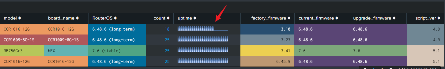

The same two ccr1016s have the same firmware version 6.48.6, but one does not work after upgrading the 5.1 script. There is also a CCR1009-8G-1S that has the same problem. I checked the update log and other files, but I can’t see where the problem is. Can you tell me what the possible problem is?Currently temporarily restored to 4.9.

Using the 5.1 script, you can’t see any action in the log after manually running it, which can be understood as not running. After manually running the 4.9 script, you can see the output immediately.

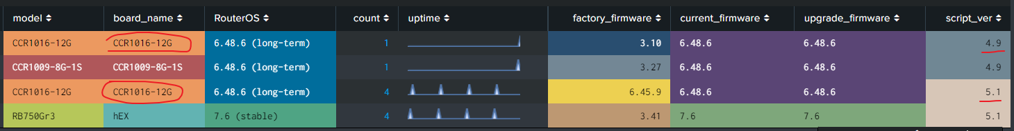

Changed to script v5.1 at 9:00 in the morning, and it will not be visible in the device list.

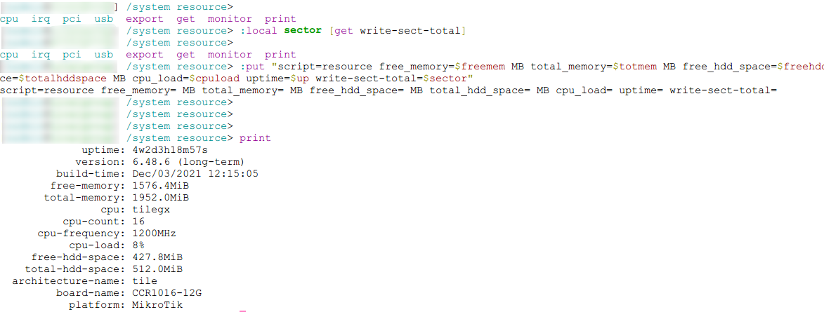

Tested the script on several mikrotik, but again there is no output, as shown in this picture. β€˜print’ will output information
You can not put multiple command line that belongs together to the terminal windows. They must be wrapped in {}.
The red colored variable show that rest of data are missing.
It looks like that you did not cut and past my post. See my example.

Sorry I didn’t read your post carefully
script=resource free_memory=1575 MB total_memory=1952 MB free_hdd_space=428 MB total_hdd_space=512 MB cpu_load=12 uptime=4w3d04:50:39 write-sect-total=
