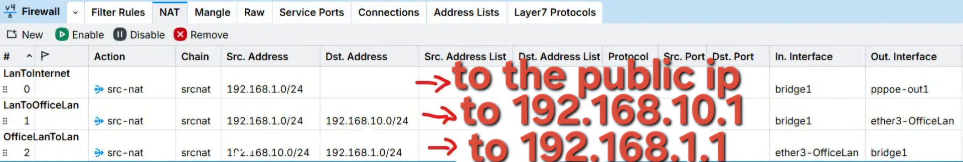

I checked everything, but the only solution I found was to create three srcnat rules:
  1. One for Ether2 traffic to the internet (from 192.168.1.0/24 to the public IP address).
  2. One for Ether2 traffic to Ether3 (from 192.168.1.0/24 to the 192.168.10.1 address).
  3. One for Ether3 traffic to Ether2 (from 192.168.10.0/24 to the 192.168.1.1 address).
This is the only way they can communicate with each other.
Are these three srcnat rules really necessary, or have I configured something incorrectly?

Hello, Thanks for your reply.
I had already tested both scenarios:
I placed the rules at the top of the firewall filter list, disabled the srcnat rules, and checked the logs.
I observed that the source client's requests were reaching the destination client using the source client's original IP address (e.g., 192.168.1.201 > 192.168.10.100); even though I set them to "accept," the connection still failed.
However, when I enable srcnat and disable the filter rules, the client requests are first translated to the gateway's IP and then proceed to the destination client using that gateway IP (e.g., 192.168.1.201 > 192.168.10.1 > 192.168.10.100). In this case, the connection is established without any issues.

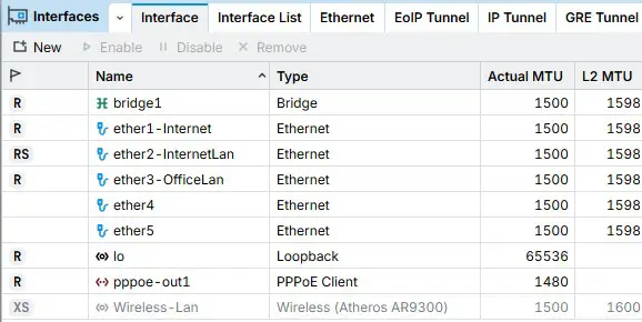

These are the settings I have on the router.
Bridge1 consists of ether2 and wireless.
however, the wireless interface is disabled, so it effectively functions just like ether2.
