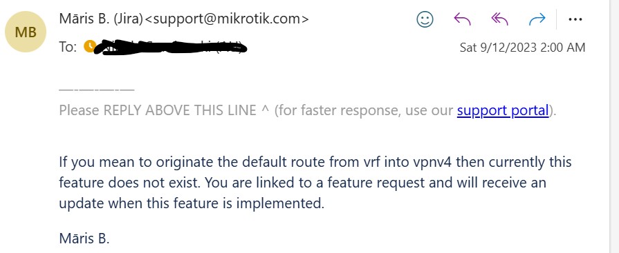

do we have any update on [SUP-134566]: BGP-VRF V7?
when that feature will be implemented.
It works perfectly fine on v6

cannot find SUP-134566 when i search for it here
