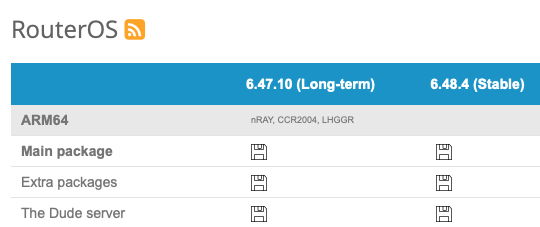

w0lt, this is not unique to the CCR2004. v6 RouterOS devices cannot be downgraded below their factory version either.
Dude, if this is the case…Then that sort of information should be indicated in the downloads page… As it is:
It doesn’t say anything…and it should.
End of story… :face_with_raised_eyebrow:

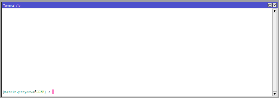

Strange and very slow/long paste code to terminal:
I had the pleasure to see that going on for 20 minutes for one script before I could press enter twice.
