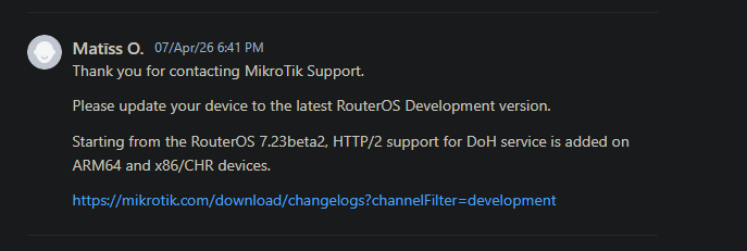

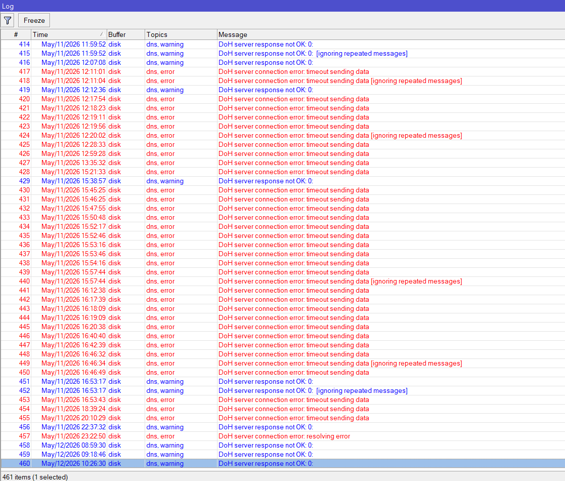

Still getting DoH errors in Log i thought 7.23 was supposed to fix these DoH issues with HTTP/2 support.
Support ticket said so, sent my Supout.rif to them and they suggested 7.23 upgrade.
SUP-214073.
This is caused by something different and has nothing to do with HTTP/2 support, AFAIK.
Have you tried a different DoH server? What server are you currently using?

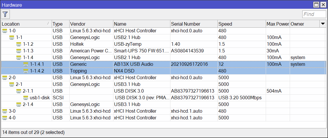

Thanks for the drivers.
In most cases, the audio device is somehow occupied by the system and can't be added to the container.
To test functionality, I had to connect several audio devices via a USB hub, and then only one was available.
Roon Bridge works with USB audio cards in the container, everything is great!
Please fix the unavailability of connected audio devices in the system.
After rebooting the router, the problem has not yet been reproduced.
