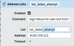

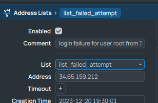

This is also one example why I have already mentioned several times that the dark theme needs improvement. A lot of improvement, to be clear. The light theme is acceptable and one can work with it, but the dark theme is very difficult to use.
I have already pointed out that the WebFig light theme has better colors. I do not understand why WebFig and WinBox use different color schemes. That seems inconsistent.
Once again, the dark theme is very hard to look at. I normally use dark themes across many applications, and my entire system and CLI are dark. However, there is something about the WinBox 4 dark theme that makes my eyes hurt.
