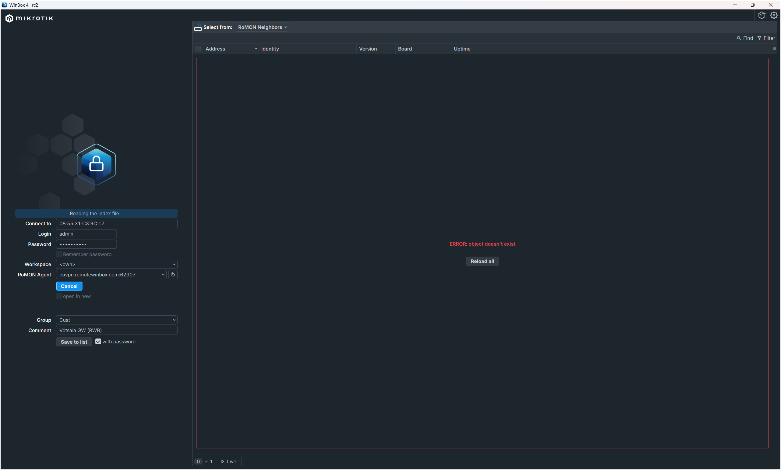

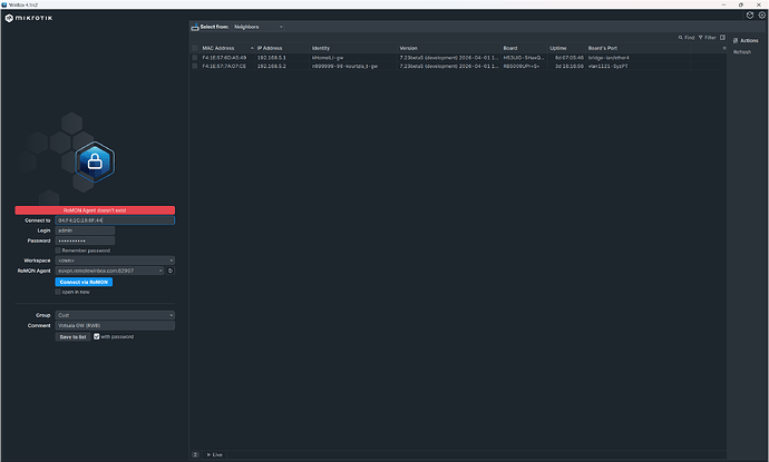

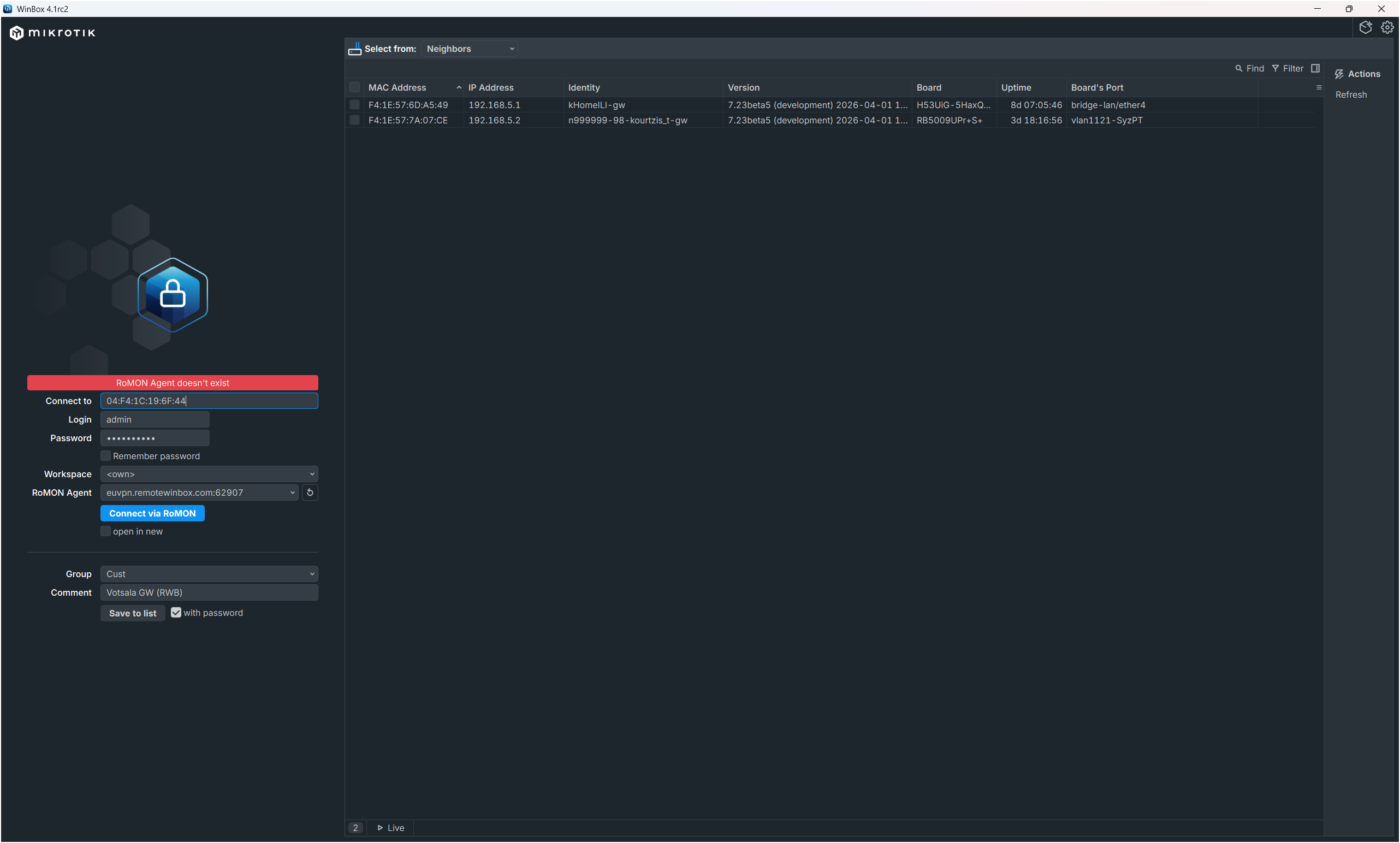

There is a long-standing problem with RoMON in Winbox 4. Very often, when I am trying to connect VIA RoMON to a device (that is, AFTER I have connected to the “RoMON Gateway” on the remote network), I either get a “RoMON Agent doesn’t exist” error (if the “open in new window” is selected) or an “ERROR: object doesn’t exist” (of opening in the same winbox window). In the first case (new window) the connection is not established. In the second case, the connection is established.
Here are some screenshots:
First case (open in new window):
Second case (open in same winbox window)
