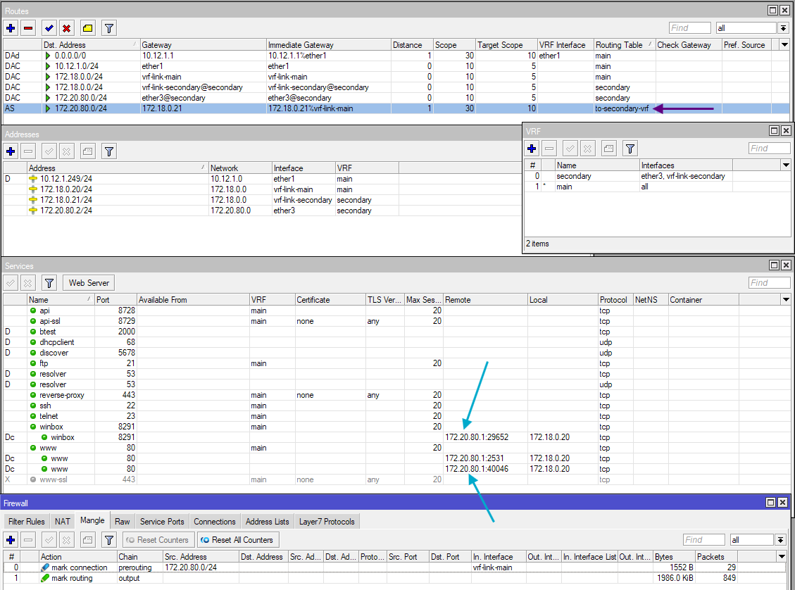

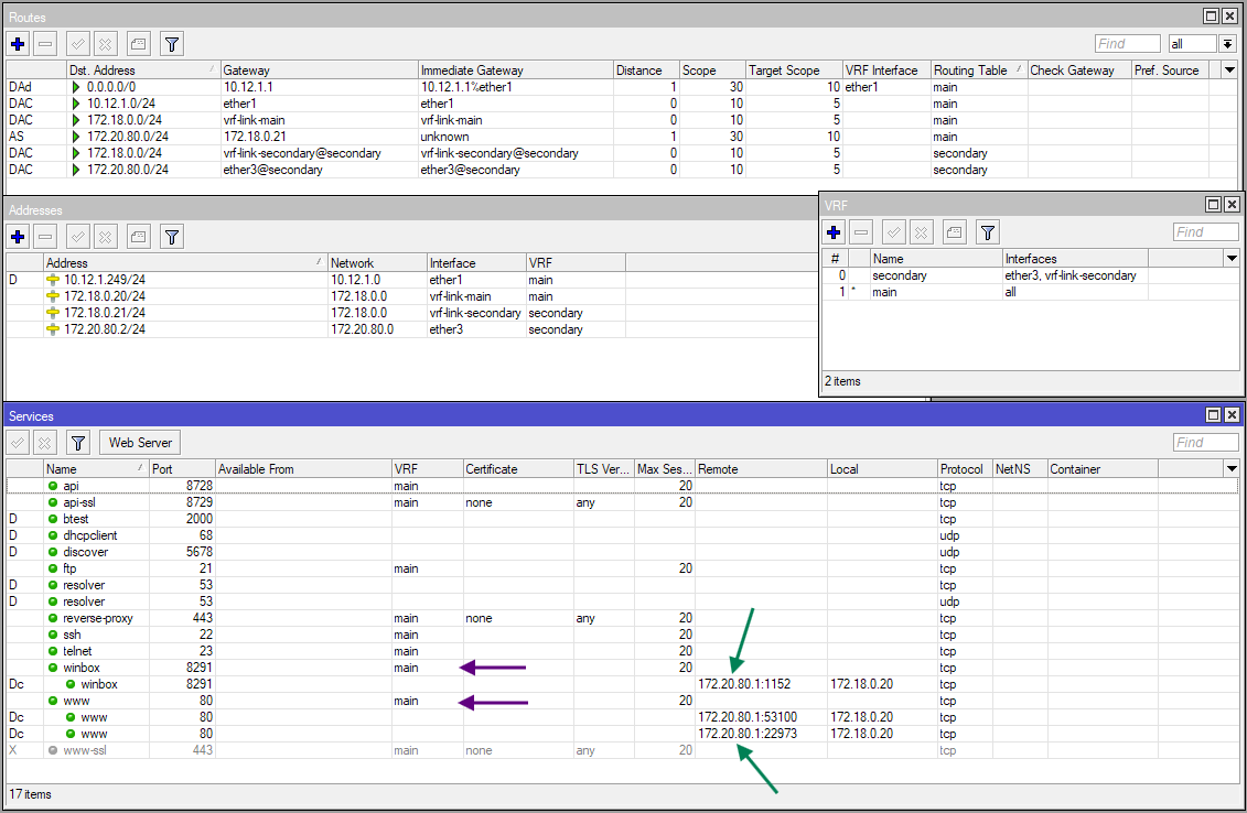

  5. After this step, the router's services will be able to receive and process the incoming packets, however, we still need to properly route their responses, by adding a route for destination 172.20.80.0/24 (subnet of ether3) in main:
    add dst-address=172.20.80.0/24 gateway=172.18.0.21@main routing-table=main
    The gateway address used is 172.18.0.21, which is the address of the router on the vrf-link-secondary interface in the secondary VRF.
    With this setup, a client on ether3 (172.20.80.1 in the screenshot below) can access the services without issue:

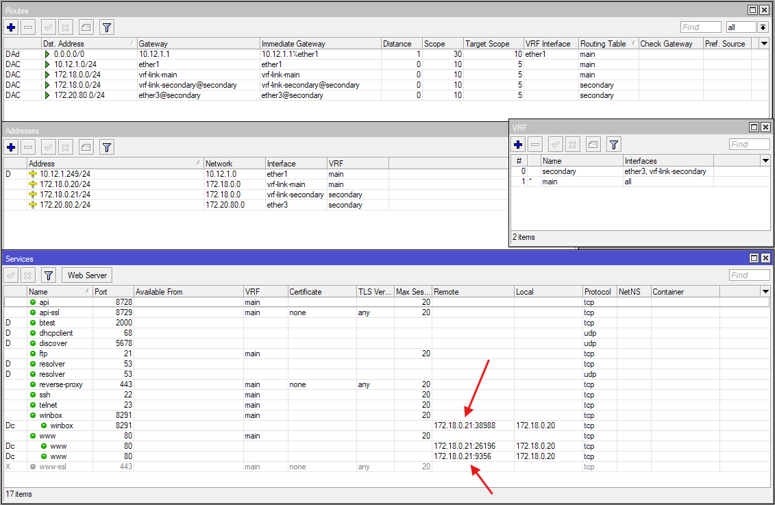

  1. Now if the route at step #5 bother you, and you don't want to leak the route towards 172.20.80.0/24 in the main routing table, then you can remove that route and apply a SRCNAT rule instead:
    add action=src-nat chain=srcnat dst-address=172.18.0.20 \
     src-address=172.20.80.0/24 to-addresses=172.18.0.21
    The downside, however, is that now the source addresses of the clients are masked, and all become 172.18.0.21:
  1. If that also bothers you, then you can get rid of the SRCNAT rule, add a new FIB routing table to-secondary-vrf with the route:
    /routing table
    add fib name=to-secondary-vrf
    add dst-address=172.20.80.0/24 gateway=172.18.0.21@main routing-table=to-secondary-vrf
  2. And add mangle mark-connection rule to mark incoming connections to 172.18.0.20 from 172.20.80.0/24 and corresponding mark-routing rule on the output chain for the response:
    /ip firewall mangle
    add action=mark-connection chain=prerouting connection-mark=no-mark \
        connection-state=new in-interface=vrf-link-main src-address=172.20.80.0/24
    add action=mark-routing chain=output connection-mark=from-secondary \
        new-routing-mark=to-secondary-vrf
    With that, the source IP addresses are retained (no SRCNAT) and there is no route leaking in main needed, only in another routing table (to-secondary-vrf)
You can pick between those three alternatives for step #5 onwards depending on your preference.
