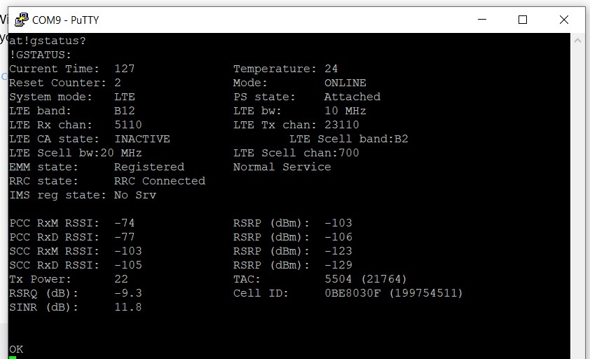

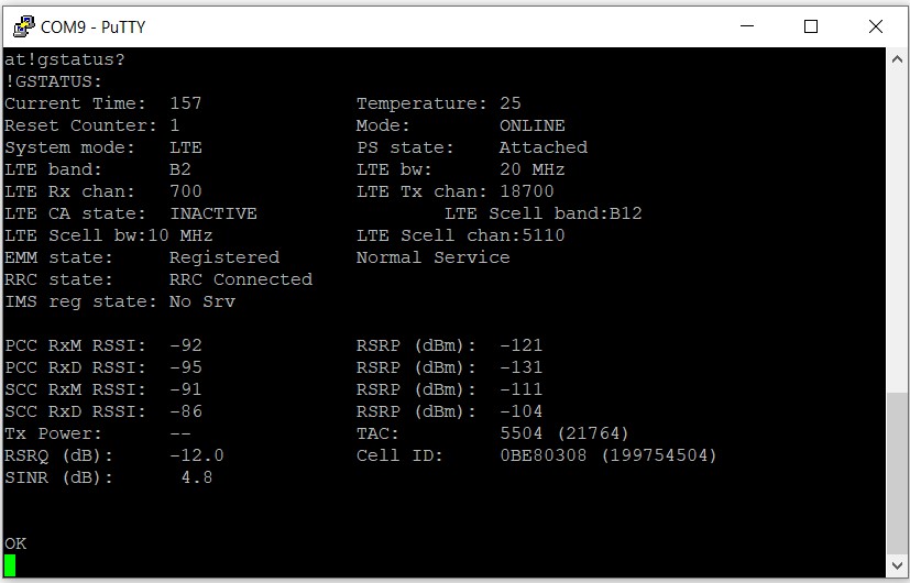

I just picked up a R11e-LTE6 to test in place of my Sierra Wireless MC7455 connecting to AT&T in the states. With the MC7455 on router OS v7.0beta4 on a hap ac2, modem in a USB enclosure with 2 yagi antennas, I’m able to get about 40mb/s down and 5-7mb/s up. What I would like is some more insight on the LTE interface page with the MC7455, but that will come in time with support, I hope. In the mean time, I tried the R11e-LTE6 since it/s CAT6 and should support CA like the MC7455. What I’m seeing is that it will connect to either band 12, 17 or 2 primarily, and only sometimes if the primary is band 2, it will show 2CA with band 5 but then drop right back up. Speeds on any of the bands don’t compare to how the MC7455 performs and it might be a combination of the low band distance and the high band 2 performance. The MC7455 also has bands 29 and 30, also used by AT&T but I’m not sure of those are coming into play. With the MC7455 connected to the routerboard, I can’t get access to the AT commands to check anything, and if I plug it in my laptop, I can get AT commands but for some reason won’t connect with data so I’m unable to check speeds. I know the MC7455 connects with CA, even if the screenshot i was able to grab shows inactive.
Some other posts show some issues with CA dropping. Is anyone able to get CA working? Thinking of trying a Telit LM940 too.

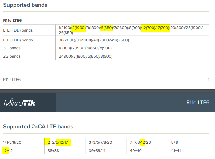

R11e-LTE6 not use B29 or B30. Maybe you should wait for lr11e-LTE6-US|4G version with better Band selection for you.
https://i.mt.lv/cdn/rb_files/R11e-LTE6-1575025885.pdf

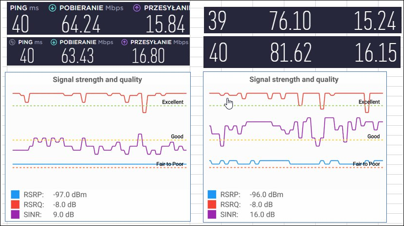

  • give a model of your usb wwan adapter
  • do in table the comparison of Band/Speed/rsrp on both modem with this 2xYAGI antenas.
  • The same but without external antenas give us a amplification per band of your YAGI.

Be sure that set band=“” means auto-selection is set to LTE6 who can connect to one of any of them and try assign the ca-band.
You can reach 2+5 or 2+12 or 2+17 means the CellLock on 2 or 12 or 17 is good way to check

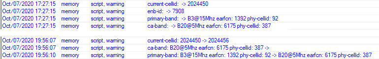

Thanks SiB for the update. I updated the script and killed it from the jobs tab. Then reran the script.
There is data now in the lte log. Should I clear the log and collect data with the fixed script?

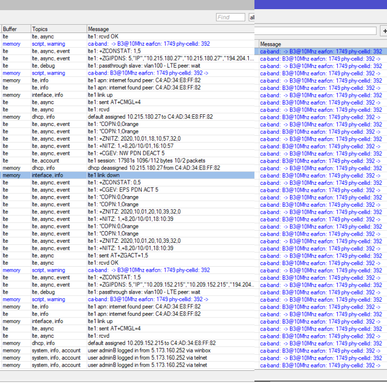

The CA was dropped and the following entries were logged…
Unless I’m misreading the B3 connection was lost (the reason isnt not clear) and it connected to the B20.
