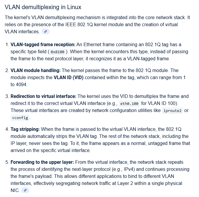

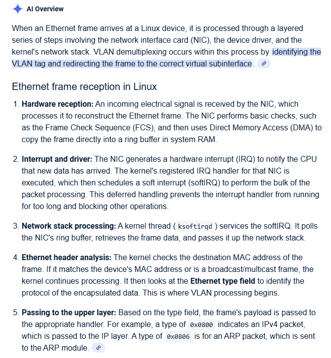

The google query what happens when an ethernet frame arrives at a device in linux? How does it demultiplex vlans

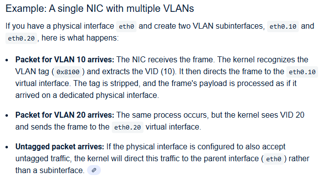

Following is what I got today (2025-09-18), and in my opinion, it is a reasonably good description. Some details are left out, but they aren't important for conceptual understanding; e.g. it leaves out details like the offloading done in most ethernet adapters. e.g. unless promiscuous mode is active, the ethernet adapter hardware usually discards received unicast frames that don't match its own MAC, so it never interrupts the CPU to process them. But the AI overview did a reasonably good job here in my opinion.
The above doesn't cover what happens when there is no tag. But the following example does.
Oddly, asking the same question multiple times doesn't get the same AI Overview.
