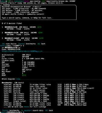

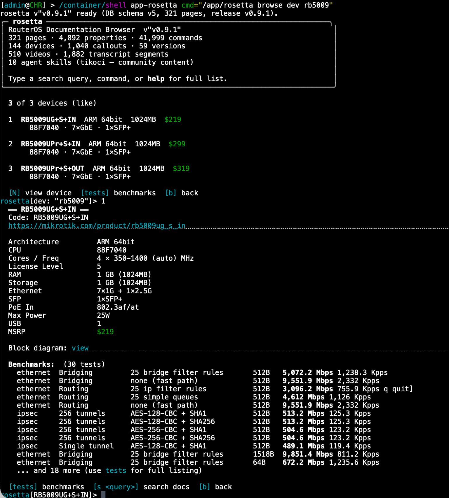

RouterOS-docs MCP I maintain — rosetta (GitHub - tikoci/rosetta: MCP Server with RouterOS docs + commands + products + changelogs, using SQLite-as-RAG, sourced from MikroTik · GitHub) —
that exposes RouterOS docs, the full command tree across many versions,
changelogs, and hardware specs as MCP search tools:
bunx @tikoci/rosetta --setup     # local stdio MCP for Claude Code/Desktop, Cursor, Codex…
It even installs on the router via /app (RouterOS 7.22+), so any AI assistant
on your LAN can query it. (Honest note: rosetta still indexes the prior doc export
and is mid-migration to manual.mikrotik.com — but the command tree and version
data come straight from the router.)

Using Rosetta as /app: https://github.com/tikoci/rosetta#install-on-mikrotik-app
And it worth commending MikroTik on the new custom /app YAML that makes it trivial to install the Rosetta MCP (and bunch of other minor improvements like multiline strings in scripting so cut-and-paste an /app/add just work). So outside the package/device-mode hell dance, it's just 3 steps, see GitHub - tikoci/rosetta: MCP Server with RouterOS docs + commands + products + changelogs, using SQLite-as-RAG, sourced from MikroTik · GitHub .
This important since adding MCP Server varies a lot. But the most "universal" method is to use a URL to an MCP Server (like Rosetta) in AI agents like Claude Code, CoPilot, Cursor, etc. Since /app will wrap Rosetta in HTTPS automatically, it's also secure without any work on my part. Previous to /app using the "raw" /container system, Rosetta setup be like 10-20 steps to explain, and add another 10-20 to setup certificates for HTTPS. With /app it's 5 commands, 1 reboot, and 1 power cycle at worst.
Further, the new cmd= support allows you to use the Rosetta /app as TUI from RouterOS Terminal. Perhaps surprisingly... all the ANSI/termcap stuff work through it. Background Rosetta also support a "TUI mode" that does NOT need AI since it just exposes searching of the SQLite DB that stores all the docs/changelogs/schemas/specs/etc. and it UX is entirely based on the SAME methods that an AI agent use navigate the data (although an agent get JSON, while TUI gets ANSI). And this can be easily accessed using one command (assuming Rosetta /app is installed):
/container/shell app-rosetta cmd="/app/rosetta browse"
Will get a search interface to RouterOS docs from the WinBox/SSH/etc terminal.
Basically I did not run into any issues in packaging Rosetta as a /app. So good work on /app, too!

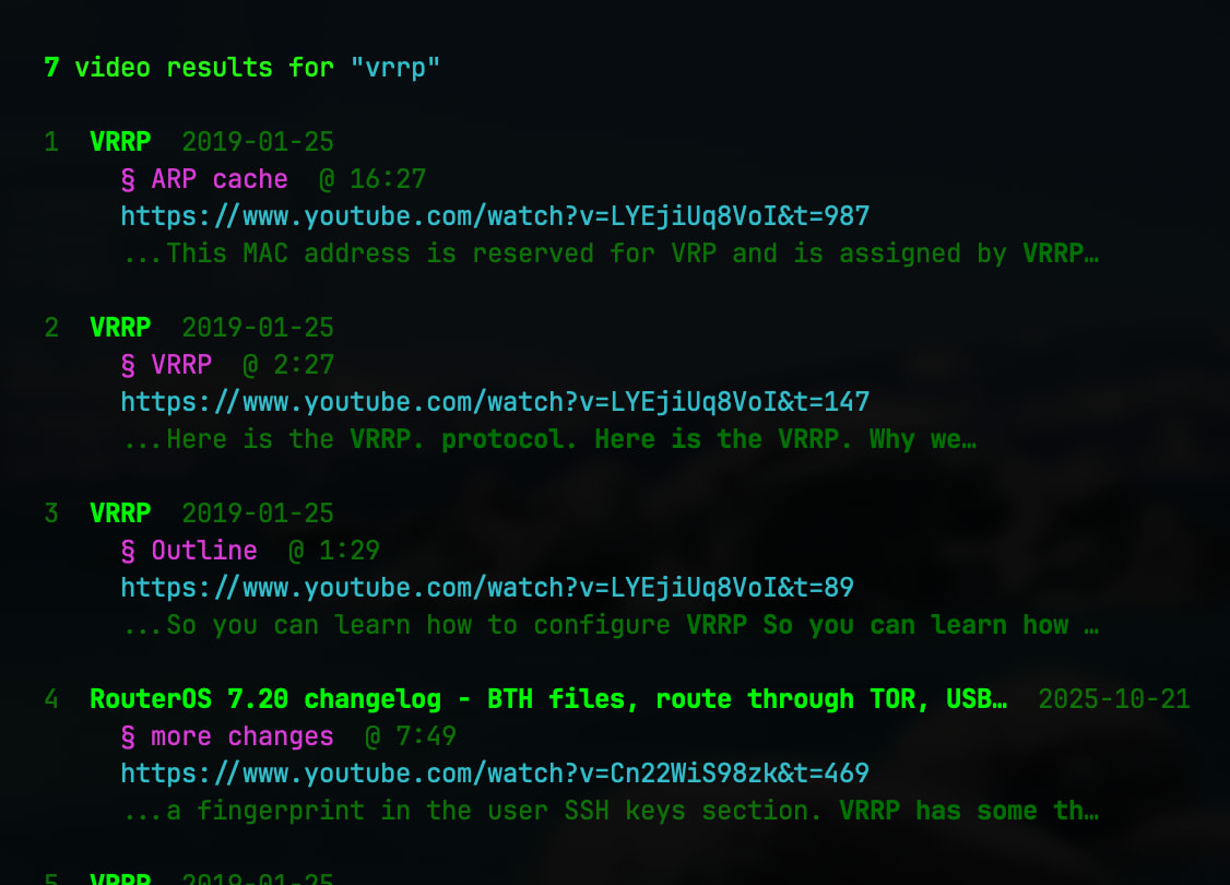

2. Downloadable "Captions"/subtitles and "Chapters" .vtt files for the "YouTube" videos
Rosetta actually also pulls in the @MikroTik YouTube channel, so the MCP know the full collection of videos. Since it indexes both the captions and "surfaces" the chapters to MCP clients, the "main" MCP function routeros_search() will also return any video results so an agent can offer a video, i.e. if task is more of an question, than request for configuration.
Today transcript/captions/subtitles from YouTube are collected by Rosetta's build using yt-dlp scrapper against the @MikroTik channel to find your videos, and then added some same full-text index (FTS5) so a "topic search" will return a videos that mention VRRP (with ordering determined by BM25 indexed ranking)
But scraping YouTube is very fragile so it's a manual process since it needs a cookie etc etc to run yt-dlp. I would have used MikroTik's TikTube site, since the underlying PeerTube seems to have a nice REST API that Rosetta could use to fetch captions and subtitle VTT files that could be using the GitHub CI. This be WAY cleaner than yt-dlp schemes that require me running them on desktop (so Rosetta may be few videos behind YouTube).
The issue is the YouTube catalog is NOT synced to TikTube... so only YouTube has the full set of videos. Now I don't specifically care about TikTube, although to me it make sense they were in-sync... But if you had the captions/chapters/subtitles in VTT form someplace else that available for download... that work equality as well as PeerTube's REST API.
How video works in the MCP server... Since the Rosetta non-AI terminal interface ("TUI") emulates an MCP client (e.g. how an AI agent would call the Rosetta MCP server) so a human can "see" the same view as future agents. So a search on "VRRP" (for example) would find the one VRRP video from routeros_search() with pointer to `, and it break response up by chapters, so it has time-based URL to sections within the video. This all works since transcripts are all fully index, so it can find related video like the "7.20 changelog" videos that mentioned VRRP changes. e.g.

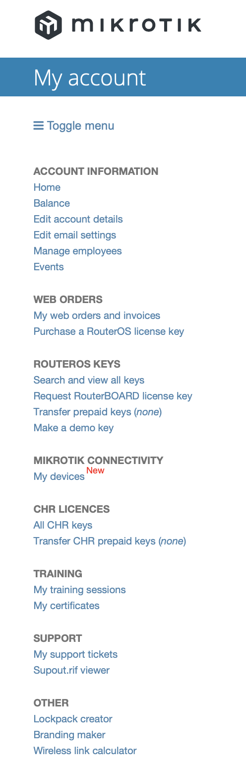

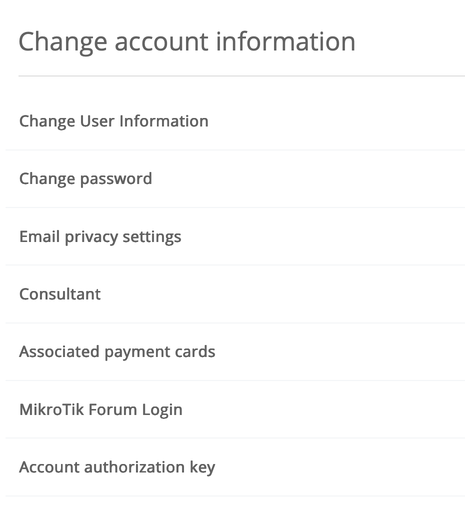

  1. Did you know we have a product API? Why not use that? It's in your mikrotik account in the profile info page, bottom
  2. we don't upload / write captions always, so harder to do
  3. We did already fix the urlencoding for docusaurus, all URLs should be clean kebab-case.
Nope, didn't know that. But I don't see it in my account. Maybe it something that has to be enabled, like Branding Kit?
Possible I don't understand "profile info page, bottom"... but even "account information" subpage does not have any API thing, other than "Account authorization key" (now IDK what that does or where to use it either...)
But does the "Product API" have the "ethernet/IPSec test results"? IMO the test results are really helpful when planning/purchasing a device (i.e. Rosetta MCP provides the 512 byte results on a device lookup, with the full results for all packet size available on 2nd tool call).
Currently, my code has to scrape that www site to find test results, and the that's the weakest part since there are some irregularities in how test results are presented. So have them as CSV or JSON allow tools to them more directly.
And, side note, perhaps the "mikrotik account" (which I presume is www.mikrotik.com/user) needs a doc page :wink:

If you want agent to know more about actual devices, there is a "hidden" page with a CSV of all products:
https://mikrotik.com/products/matrix
This has a rich table most LLM could consume, and any agent have much better chance to "reason" through the new .md docs mention in top post, when it has the row from the product.csv. e.g. it know your models #ports, switch chip,, arch, etc. etc. etc. - so when AI is reading the manual.mikrotik.com, it has YOUR devices CPU/arch/etc in the current context which is going to prevent guessing from training.
My Rosetta MCP makes this more efficient and more automatic... since product CSV is a database table... but I can assure everyone an agent know the specs for your model is going to dramatically improve results (however it get its).
I commented on the manual.mikroitk.com and suggested a Docusaurus plugin that resolves between switch/CPU chips and models and their abilities (PTP, HWQoS, PoE, "beeper", etc) would be useful so the doc pages have the mapping someplace already... But the release note above is the proof-point of why. Although the release notes are not index by Docusaurus today, some principle applies.
Well, you highlighted a weakness in my AI toolchain, nothing knows about a supout.rif - but that's actually a good idea for my tools to know about. Since it's information dense so an agent can more easily check all the various bits (e.g. the logs and other Linux-like stats shown in other sections). I'd never thought about it. :thinking:
Rosetta MCP has all of the restraml schema tools data build - indexed by RouterOS version. So it has a fair chance of using the command/attribute data to verify a config file, on top of all the potential sources to check. For example, not only release notes, docs, matrix.csv, etc. but Rosetta even indexes the YouTube video transcripts, like the "What's new in 7.2x" series of videos. e.g. Rosetta is a "one stop shop" for RouterOS information, all indexed (and AI agents pretty good at constructing cleaver queries based on your prompt) and allow for "progressive discovery" (e.g. first result returns points to various sources for the search string)
Data Source Coverage
Documentation pages 317 pages (~515K words) from the retired help.mikrotik.com Confluence export
Property definitions 4,860 with types, defaults, descriptions
Command tree 5,114 commands, 551 dirs, 34K arguments
Version history 46 RouterOS versions tracked (7.9–7.23.1)
Hardware products 144 devices — specs, pricing, block diagrams
Performance benchmarks 2,874 tests across 125 devices (ethernet + IPSec)
YouTube transcripts 518 videos, ~1,890 chapter-level segments
Callout blocks 1,034 warnings, notes, and tips
And depending on your AI tools, there is often some schedule tasks that could say check daily the mikrotik site, and then review some directory of your config files against any new releases notes and/or documentation updates.
And the later goes to @fischerdouglas commentary in new manual FEEDBACK thread about the changes to docs being a important piece of metadata, since if you do run on it on a schedule and if agent has already done some comprehensive review of config/monitoring-data/etc., it only need to confirm things that were updated. So the /console/inspect/"CLI Reference" knows the command tree... the "prose" in the docs related to those changes is often equality important.
At this point, I've been more interested in developing AI-enabled RouterOS TOOLS that could underpin "higher level" things like UI or site-specific tooling or whatever. Since I started a couple year back cateloging the RouterOS scheme, I've largely been trying to wrap that all up (and more) for AI. Which has necessitated some thinking about "what agent an needs to work with RouterOS"....
Rosetta MCP is really just SQLite DB with all of MikroTik "stuff" and MCP just wires up SQL queries to it for an AI. Or you can use bunx @tikoci/rosetta browse to get a non-AI TUI which also does searches.. Since it has an AI-friendly interface, you avoid agents having to parse something like manual.mikrotik.com/llms.txt - which will help a lot over nothing - but "digging deeper" is harder using web retrieval.

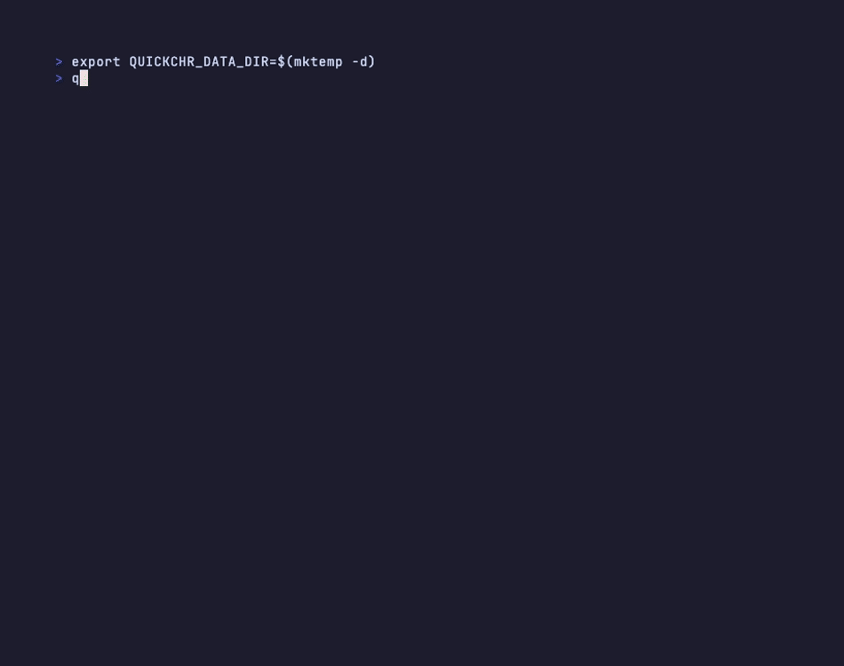

But mainly I've been working on the other part of my RouterOS AI tools "trilogy", which are two CLI tools that human or code-based agent can easily interact with RouterOS, both real ones and "fake" ones for testing.
quickchr — Fastest path to MikroTik RouterOS CHR instance for testing and scripts
So one tool is quickchr, which allows an agent (or human) to easily bring up a CHR at specific version & fully provisioned (device-mode, packages, enable trail license) in 30s to 1m. I have a lot of unit/integration tests in various project that are based on quickchr since it work as both GitHub runner (which in turn is used to build the schema used by Rosetta MCP) & quickchr also run locally (any Mac, Windows, or Linux with QEMU stuff installed).
But essentially, a human run bunx @tikoci/quickchr setup which bring up a wizard for bring up CHR at version/provisioned via a wizard.
wizard-demo
Or an AI agent can construct a more complex CLI with args to bring up what it want to test (assuming you prompted it to use quickchr to validate something). Overall, quickchr is pretty solid at this point.
The networking scheme is a bit "funky" at first, since out of the box it prefers QEMU user-mode networks to avoid needing sudo or root. This also ensures it's "easy" to start, without needing to provide an LLM creds or constructing complex networking setups, etc. e.g. if you want to test a commands or config, you may not need a high powered CHR to just know something "works". See networking doc: quickchr/docs/networking.md at main · tikoci/quickchr · GitHub on the more esoteric networking schemes employed. There is TUN/TUN support as well as first-class Mac support. e.g. can use the native Hypervisor framework (via QEMU) to access bridged or "shared" network - this requires sudo once to setup, but then can be used without root when a agent/human wants to use quickchr
And there are some example usages here: quickchr/examples at main · tikoci/quickchr · GitHub
