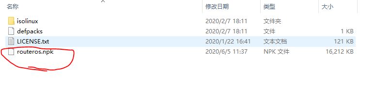

You can make your own 7beta8 ISO file , Just use the ULTRA ISO to edit the 7beta5 iso file and replace the routeros.npk in it with the routeros-x86-7.0beta8.npk (rename to routeros.npk)
