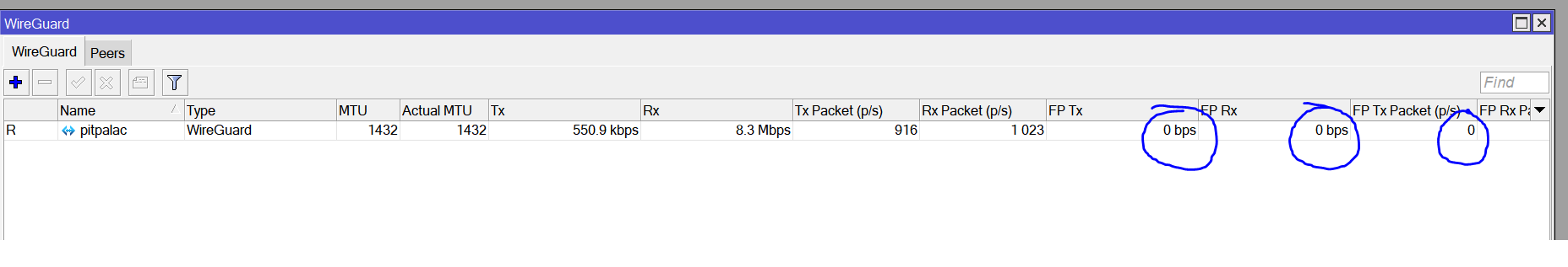

Any way to get fastpath working on Wireguard tunnels so we can get more performance out of it?
Fastpath works for PPPoE for example, but not for Wireguard?
I know Wireguard uses built-in kernel module, isn’t that fastpath?
I wouldn’t count on wireguard, openvpn or zerotier use any Fastpath. They are all CPU based.
